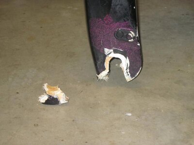

can this stock sn pole be fixed? it broke on one side where the pole bolt goes through.
and if yes, whats the likelihood a fiberglass newb such as myself could do it?
thanks for any advice

Should be fixable, just run a few layers of cloth around the base [if there will be enough clearance for the mount] and drill new a new hole. Shouldn't be too hard, just make sure you use epoxy resin and get all the air bubbles out.
