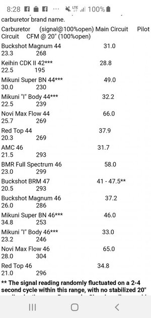

Was it this one ?nick at carbon tech and his crew ran blackjack carbs on their superjets back in the late 90s/early 2000s.
they were constantly out there with the radar gun and tuning for max performance.
these were race boats but they had big bottom end which is also needed for racing.
they ran blackjacks because they worked, not because they had to.
looking down the throat of an annular discharge carb when you wick the throttle is a cool looking sight.
they sure look like they atomize the fuel nice.
too bad we now know that dont mean $hit. lol
i thought i once saw a chart on the signal strength of verious carbs on group k.
There is big profits in custom carbs. People don't know much about venturi sizing so making them bigger is an easy sell.Was it this one ?View attachment 378520
