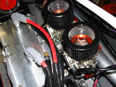

Does SE have a website? Should be staright forward. Malone runs a staright aluminum pipe as well, but his is 2in I believe.

malone way telling us he has a resonator in the hull ????:rolleyes: He also said he runs water into the exhaust outlet which will quiet it down some.
my .02 ..........Resonator my a$$, his ski is loud as sh** :haha:

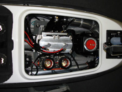

I have made them out of Carbon before. I had issues with the carbs hitting! It was fine during normal riding. But when rolls come into play. You would be very surprised just how much your motor moves around in there!! Unlike the carbon, Alum will just dent & you can keep going. The carbon didn't fair so well.............. :bigeyes:

On Malones ski the exhaust mounted a little lower on the bulk head so the tube does not have to cross the carbs as much, rather it is positioned just under them.
