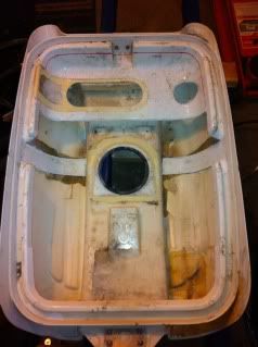

love your 750 build i went through it a couple of times to get ideas and what not .nice ride! thats a good idea with the go pro to see where the water is coming in from..no i know it doesnt have that done i havent done anything to it since i bought it last year. but my hood is cut inside where the tubes were suppose to be so the water is just falling from the top of the hood to where ever it may go. i know thats a problem i want to do my hood like yours.you think a blowsion hood is worth the money on craigslist for 175 or i should just gut the one i have to set it up like yours
Blowsion dosent sell the liners anymore, if you could get one for 175 Id do it. I just cut mine up and made my own liner. It was easy and didnt take that long. It was also my first time fiberglasing. If you need anymore pics I can send them, I took some along the way.
Well it's an as on Craigslist for a 750 listed as a complete blowsion hood but I emailed the guy and he said its 20 pounds so I figured that's about the same as a stock one which isn't worth it .if you could send some pictures over then that would be awesome I'm going to start on it soon .i scored an extra hood recently to practice on !
This is where it started and what I wound up with, I used three intake tubes in the end just to be safe.
I tried to buy the blowsion hood liner they list on their site but they said the mold was defective or lost and they quite making them. Like you said, at 20 lbs its prob not worth it though. Mine came out at 16 I think. started at 21. Foam was soaked.
is that the same one as your black hood up above?i love that hood its so clean. here's what I did today seeing yours but I wanted to cut as much as I could to go the most weigh off. this is just a practice hood.
Yea, the black is just the paint after I finished it up. I cut everything I could including the center part that bonds to the outer layer, that part was tricky to say the least. I left the rear area there to help make a airbox. Its important to have some area there so you can direct the air/water to where you want it. It also helps with support and flotation.
On the next hood try to leave the rear section there so all you have to do is close the front of it off and add your tubes. Dont forget to open up those rear intake too since that will be the only place to get air in when your done.
