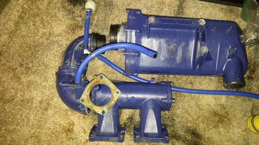

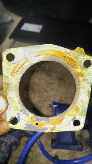

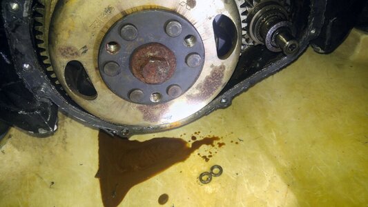

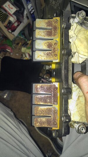

here is my situation i got a 2001 super jet in march and have been riding 3 or 4 times a week rebuilt the carbs did a little tuning got it running pretty good as far as i could tell. but then my battery died so i charged it and couple days later died again so i checked if it was being charged and the volts were the same weather it was running or not. i preceded to pull off the timing cover and sludge came pouring out a little research later i find out most likely that my crank seals are fuked. when i rebuilt the carbs i pulled the reed cage out to check it and it had a decent amount of surface rust on it i will insert a pic along with a pic of the sludge also. so going by that i would have to assume that the crank probably has to be rusty also and isnt rust the killer of cranks? with that said i did remove the reed cage / intake manni and looked in with a mirror and turned the engine by hand and didn't see any rust from what i could see as limited as it is from this angle. should i be looking into having the crank rebuilt also since replacing the seals i have to tear down the engine completely right? this is not as much of a question as its my thought process going forward and would like any advice or tips as you all see fit. what would you do if this was your ski? thank you for looking you help is much appreciated.
