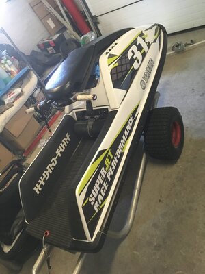

Hi guys, I have a good old 701 square nose, with a little problem.
When I point my steering straight ahead, it turn a bit to the left.
Where do I adjust that, if even possible?
Thank from a Danish guy.
If you remove the Chinpad you will see where the cable attaches to the turn plate. You can adjust it there or where it attaches to the steering nozzle. What I do to make sure the nozzle is perfectly straight is to use a 4' level on the nozzle. Once you get the same measurement on both sides with the handlebars perfectly straight you are good to go. Hope that makes sense.
