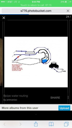

just put my Ada head kit on with 35cc domes and have a factory b-pipe. Ada recommended using the cooling system I already had set up but after riding shortly head and pipe were piping hot. what is the best cooling system for this setup???
This is the way it was recommended to me from jet maniac. It work really good
For the gulf and really warm rivers in Alabama.

May have been a bit paranoid about burning up my engine. It was warmer than I was used to. It's warm to the touch but doesn't sizzle water. Ran it hard today and no heating issues! So all is well thanks guys!
