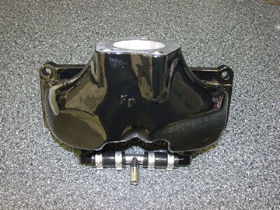

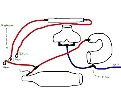

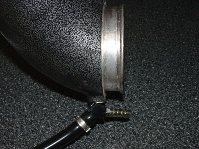

Have you seen #0's setup? 1 Line in with 3 lines out. :bigeyes: This is by far the craziest setup I've seen, but it keeps his engine cool and he only rides in hot Florida Water.
Yes I have seen the setup, he could just as easily tee the manifold into one however that is more difficult with the Riva head.
