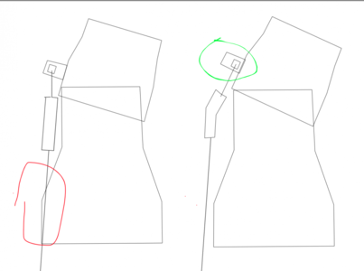

I've been playing around with my steering a bit and came to the same conclusion I always come to - My nozzle can go further to each side than my steering system allows. It appears this is because of the attachment point position on my trim (Raptor). I'd like to move the attachment point about 1/4-1/2" closer to the nozzle to achieve more throw at each stop position.
The problem:
The steering cable is already barely touching the pump at full lock in each direction.
Proposed solution:
I'd like to cut the threaded rod on the pump end of the steering cable and put an angle in the middle. This will allow me to then redrill/tap the steering nozzle closer to the inside allowing more throw (and faster steering)
Has anyone ever done something like this? Will the weird angled stress on the steering cable cause major problems? Short of moving the steering cable exit in the hull, I don't see any other solution.
See attached crappy drawing for a visual of what i want to do. Current situation is on the left, proposed solution on the right
