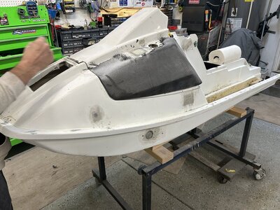

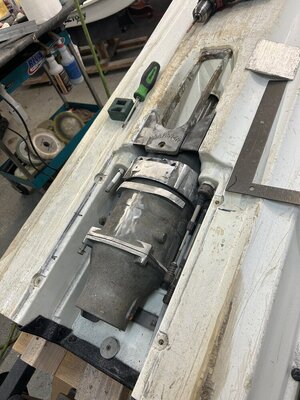

Loving this little Noco lithium battery. We weighed the original battery it came in at 16.2 lbs. The Noco is 2.58 lbs!

I'm wondering why a 951 would be more sensitive to water ingestion than say a dasa 970 (similar bore and stroke), and I'm also surprised that designing an airbox is so hard. But, I've never tried, so maybe it really is that hard.
Open pod filters mounted in that position do seem pretty sketch in an x2.

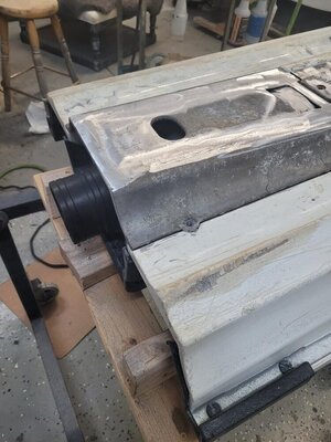

Thankyou very much! We took a break for a week after hammering down on this thing for the last 5 months straight. My dad was messing around with the primer and ended up with to much fuel in the carbs and baboooooom. Backfire took out the waterbox for the 2nd time. So we’re gonna tear it all back apart and reengineer a new design. Stay tuned!
Might be able to have someone weld you a custom one. Raddudes does good work.
