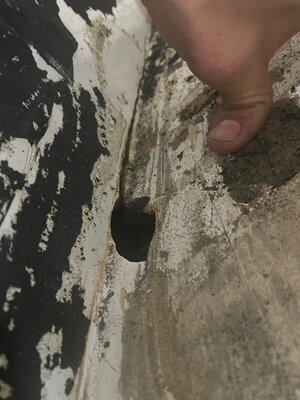

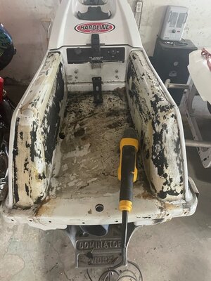

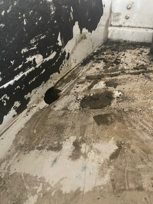

Wet Tray means that Water is allowed to pass thru the Tray and exit thru a pair of Duckbill Flappers that I installed at the bottom of the Transom. Like the Kawasaki SXR 800. Also have an Electric Bilge in the Engine Bay.
The Ribs are meant to provide support to the Gunwhales since the OEM Foam is no longer there to do so. Those Ribs were epoxied and fiberglassed. I only ride Buoys so it should suffice.
This Square Nose came with several cracks in the Tray and wasn't sure I found them all, so no point in wasting expensive Closed-Cell Foam into a Tray that may leak again.
