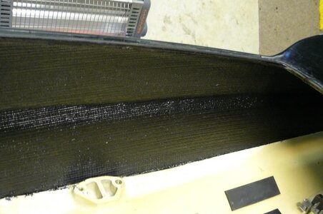

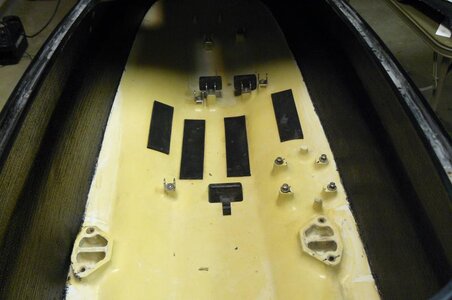

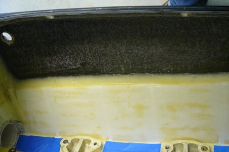

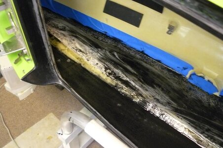

Well it's coming together . Did my reinforcement last weekend .I just decided to do the sides and use a heavy backing plate under the handle pole area. 48 black jacks came in along with some other goody's from Art . I picked up a XFT X-9 hood (odd color ,but who cares it will be rattled canned any way).
pic 1 bond line
pic 2 DAMN IT (epoxy kicked real fast) do yourself a favor put the epoxy in a flat cookie sheet instead of a large mixing cup it will give you waaaaay more time to apply. I got glass down and at the mid way point it kicked . If this happens do not hesitate you can't stop it.........just say &^(*&^*& rip it out and start over with a new batch of epoxy and new cloth.
Pic 3 and 4 " The save "
It came out well for my first one. I'll do the hood lip with some 6 oz 2" inch tape. The biax was just a little cumbersome to deal with due to the tight bends.

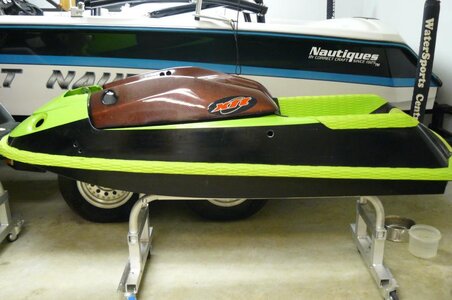

I was really insulted when my wife came down to the basement looked at the ski and said " You do know..... that those colors don't go together..... don't you " . I replied, "you are absolutely wrong day glow green is an outstanding color that really ties the black and red together" WOMEN what do they know about fashion. This color scheme is all the rage in Europe .

Rides really well. Thanks for coming down and letting us ride it. The engine is pretty too. I'm curious what happened to your turf though. I just thought you hadn't gotten around to turfing it but it looks like you took it off.

sweet ski with plenty-o-power. real nice setup. i didn't get to check out the engine bay when you had it here. post some pics of the finished product.

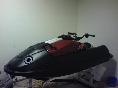

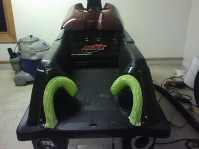

Here's is a few shots of the motor etc. I need to decide what to do with the foot holds. I really like the xft x-3's ( comfy ), but I'm real stretched out. It feels like I need to a few inches forward. i have heard this complaint from most of the people who have them. It will be a real pain to move them so i may just try to adjust .
Just take some time to get used to them. Pretty soon you won't want to ride in any other foot holds.
