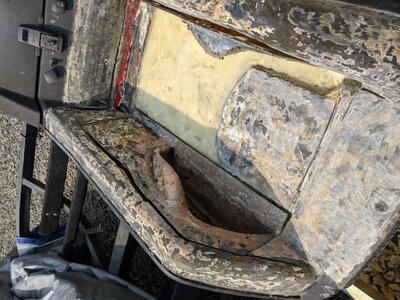

Ive cut the entire tray and side walls off, and holy crap is it hard to dig that foam out.
Can that little drip hole that i patched up really cause the entire hull to be water logged? Im worried theres other leak areas. I also noticed the ride plate mounts go right into the foam, seems like water could get threw the screws there? Im also having troubles defoaming around the pvc pipe to inspect breakage. Maybe the pvc pipe or exhaust seals are leaking. Anyone have any tips? Maybe just get it refoamed and work on sealing it from the outside?

Yes it sucks. You can try a wire wheel on a drill or a pressure washer etc. Add real drain plugs to the rear and use solid foam like the sheets of the "pink stuff" at home depot. Do not use pool noodles as they absorb water eventually.
Yes, pool noodles are made of ethafoam which is what we used to carve bulkheads out of for our fiberglass white water kayaks. And it does absorb water. Styrofoam does not.

Why would i not use 2 part foam for everything, that stuff absorbs? So. Basically just planning ahead for the inevitable leaks into the hull? And sorry, can you expand on what you said on drain plugs. Where and what are those?

Here are my concern areas. Should i just glob some resin and cabosil or marine colk and throw it over the concern areas before i foam?

Hey guys, i bought 5200 marine colk. And i kinds just threw it everywhere. Every bar and pvc pipe seemed to have a leak at the end. Did i go overboard ? Or any other tips before i foam it up? I think im using 2 part foam for everything? I dont want this thing to leak again
Pics of colk and it defoamed

I foamed up the bottom and sanded it flat. Which made doing two layers of biax ontop real easy to do. I also had a good idea of pouring foam on the side walls and putting my cutout footholds back in and just pushing on it with my hands till it hardened (4 min). Then i just layed a cloth tape along the seam. Easy peasy. No clamps or screwing needed.
