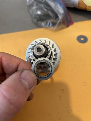

I need someone to take a caliper measurement for me.
This 701 motor had the larger bendix washer ( for the case side) installed incorrectly on the cover side. That washer is now malformed and probably not Oem.
I will have to fabricate a washer to fit.
I don’t know the O.D. or thickness. The center i will drill to fit - if you have the I.D. too it will help).
I assume it is stainless.
Please and thanks in advance ..I don’t want to waste a day on such a simple stupid thing. Bc3

Thank you - best i can find stainless washer right now is so dang close i don’t think it’ll be an issue.
Measures :
.997 OD - smidge larger but back of bendix is flat
Thickness is .0455 but spring on other side of would allow for more thickness i believe
ID drill will be 15/32
Good to go?

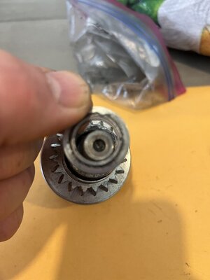

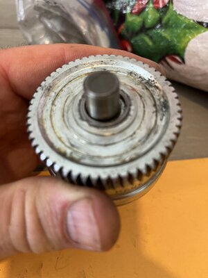

Here’s what was on bendix that caught my eye :
Stockton
Yeah you’ll be good… it’s only .0055 thicker, so no big deal and your good on diam too…
For ref I have an engine that can’t run the rear washer due to a machining anomaly in a billet case and it works fine
