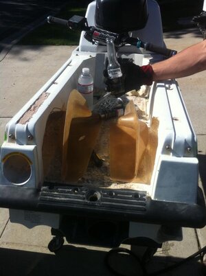

photo.jpg made the cut outs on the 615 footholds. Was kinda difficult coming up with a template considering the holds didnt come with one. The left side with the fire extinguisher was kind of a pain but we were able to make it work. Had trouble with the holds fitting flush because the ways the 550sx tray walls are. Never the less was able to manipulaite and rivet them in.
