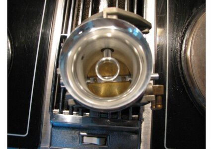

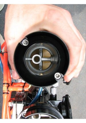

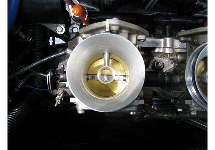

Pics: Full spec, OEM 44's w/o choke, Riva Power Bombs
