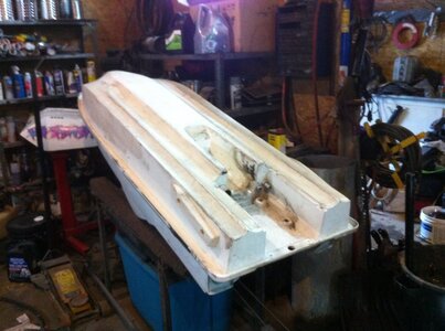

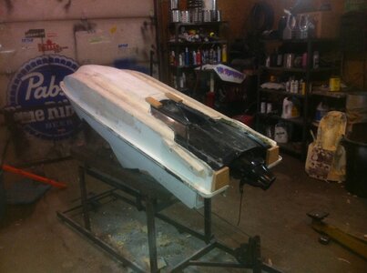

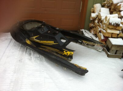

Anyways here is a little info on what I built and how I built it. I started with a kawasaki 300sx And gutted it completely. Then I got a 2000 sea doo xp 951 hull and cut out the hole pump cavity including the intake grate area. The reason I did this is because if I want parts to repair it or upgrades parts are easy to find. Intake grates, ride plates, steering cable, props , pumps wear rings and bearing kits are all off the xp and are direct bolt on!!!
Then I took the 300sx hull and cut the back pump section out and glassed in the xp pump section. The drive shaft hight got raised about and inch to help the hulls match up a little better. Then I mounted a js 440/550 bearing carrier to the (fire wall) bulk head what ever you wana call it. I used a aluminum drive shaft with the end of the xp shaft for the prop. This was the only machining work required and was nothing Majour to pull off
Now we are ready for the motor I used 750 sx motor and engine plate. And got some aluminum flat bar to mount to the original 300 mount glassed in the hull. Then mounted js 440/550 motor mounts Then put the motor in place lined up with the coupler then filled the gap from the from the motor plate to the mounts with some 2" angle then welded the angle to the mount.
Now at this point the rest is pretty well straight forward. Hook up exhaust, electrical , water, cables , fuel and boom your flipping waves in no time!

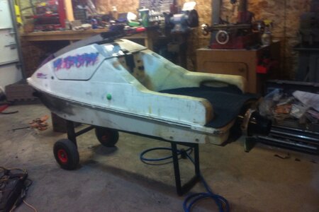

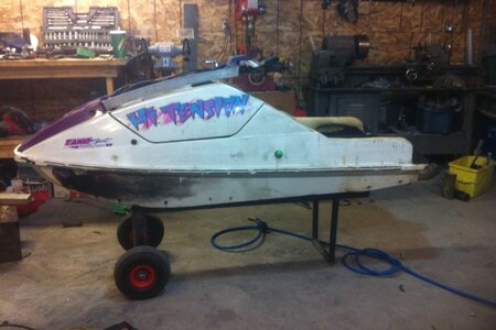

The first 2 pic of the ski is how it sits. Those pics are with the pump in and how I had it when I was riding it the past summer
Like I said I didn't waste any more $$ or time making it pretty until I knew I was on the right path. And like I said now I know I'm on the right path and it flips as is all I can to is upgrade and make it even better!! So I'm looking forward to this summer to see how much it I proves.
Yes I have been poking away at it and constantly changing things to try and make it better I widend the front end and shaved the the front of the hull flat to take the v out of the front to get more pop of the waves instead of cutting threw the waves. My current problem is I don't have enough bottom end at the moment but I just installed a 6/12 impeller last night so hopefully that will fix my problem I will be out on it this weekend so at that time I will take pictures and a update on how it's working
