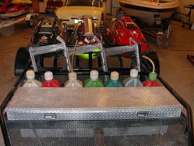

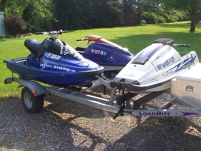

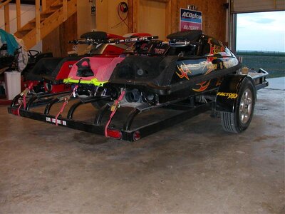

I don't think you can get 2 super jets and a b1 three across on one trailer without either raising the b1 up higher than the super jets or exceeding the legal width limit of 102". We had to put an extra super jet mount on the front of our three wide trailer to haul 2 super jets and a b1. Our trailer is pretty wide, the axle is off a boat trailer made for a 27ft Formula.

Neil, thanks for the pics.

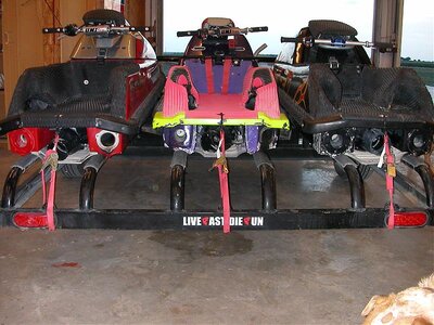

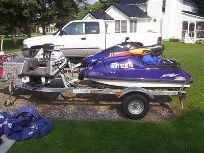

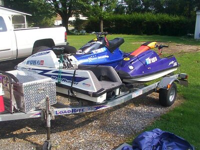

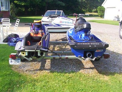

here's my setup.. i know it's not triple side by side by side... but it's really easy to get the front ski on and off.
