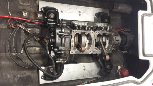

You'll also need some bedplates to bolt the 800 engine into the krash hull, and hopefully the exhaust fits.
Yup your right. I have a bottom end with mounts on it , and the krash bed plates are to short. Gonna see if i can make some. And thanks for the waveraider advice. Ill post a wtb waveraider 155 wear ring.

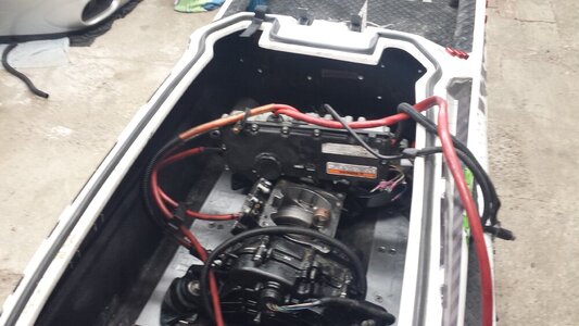

So this is kind of a on and off again project. Im also in the middle of restoring an Mustang. But here is some progress with questions if thats okay

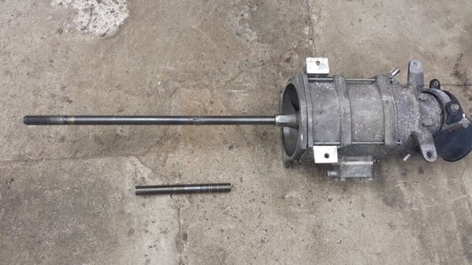

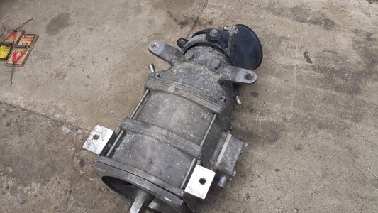

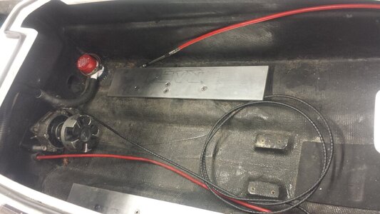

20230603_131406.jpg So i made my own Bed Plates, I will fancey them up later. Also i have shortened to pump shaft to fit. But i do have questions on what some of the fittings do on the pump. Is there 2 suction lines off the nozzel ?

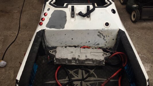

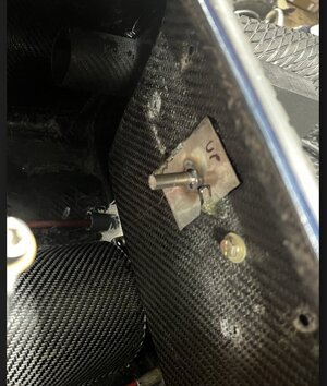

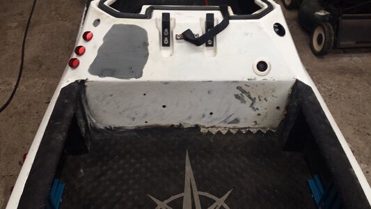

Also looking for a better way to mount the ebox then just drilling holes threw the hull and sealing them up any ideas ?

On the nozzle, One fitting facing forward is for the siphon bilge and the other is for the streamer thing that shoots water up in the air.
The box looking thing on the stator facing forward is you water supply line.

“Also looking for a better way to mount the ebox then just drilling holes threw the hull and sealing them up any ideas ?”
That is the most common way to mount an ebox. Cold Fusion makes a bracket you bolt thru the dash, then mount the ebox to the bracket on the inside. Not a lot of choise’s. Anyone else have an idea
