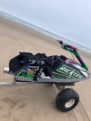

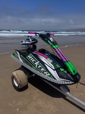

Just sold the SV1 and picked up a Edge! its a carbon hybrid layup FR. It will have TPE964, RRP exhaust, Torent 155mm pump , JS ebox with msd and all the normal stuff, dual 46's, have not decided on gas tank or tanks yet. Starting with turf now, i have just about everything so far. I need to rebuild the topend on the 964 already has the cylinders re coated and ready to go, pistons, need a flywheel as well probably just OEM one machined down at my limit for build cost! lol
Bay Area
Turf is almost done! just need to lay the foot area. A good buddy has a laser cuter so I might have him make me a custom dash graphic out of turf. not sure yet. Steering was rebuilt as well I think I prefer the RRP over the blowsion steering. I have Gomez Surf hold going in on the right side also.
Bay Area
test fit, started it and sounded great!! I did all cooling and exhaust last night. things i have left
-install throttle cable the RN cable was to short for the Push Industries intake
-Figure out the straps for the blowsion gas tank, hull inserts fixed and install
-Try to make Battery fit the tank.... its close real close! little sanding , lube and elbow grease should be a perfect fit.
-Wire up Bilge pump, using the Wax Racing harness and rotary switch
-Just ordered a VersiPlug for the scupper should be here monday
