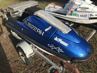

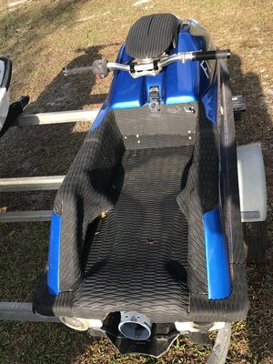

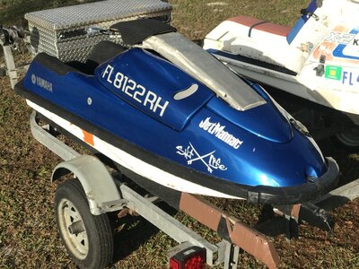

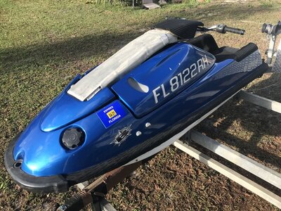

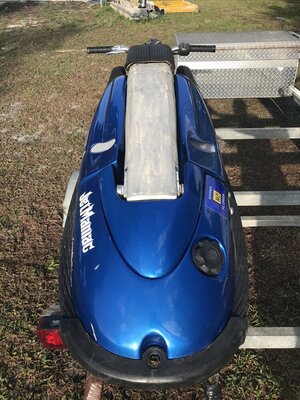

Doing this boat on the side for a buddy of mine.
2000 SJ all stock
Hull
REV footholds
Diamond turf
Trim tube installed
Clearence the hull for a trim system
Trim excess material off the rails
Smooth out the bottom of the rails for comfortable and safe grip
Defoam and refoam
Seal up all lines and hoses through hull
Install bilge pump and outlet
Motor
Riva ported cylinder
Factory B-pipe w/ mod chamber
Riva intake manifold and reed spacer
MSD enhancer
LPW lightened stock flywheel
Dual Riva 48mm Powerbomb carbs
Prok flame arrestors
Riva girdled head
Primer installed
