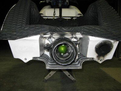

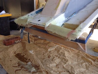

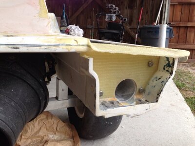

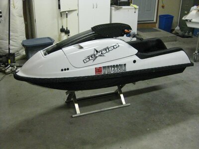

I went -2 on my x2. I shortened the hull 2" on the bottom and 1.75" at the bond rail. I was careful to cut it cleanly. I then made a jig (on the outside over foam on the inside) to remake the end of the hull. This allowed me to put in barbed tee nuts and my rear exhaust. I then put a piece of painters drop plastic on my bench, 2-3 layers of cloth, then set the pieces I cut off the hull and put a cinder block on them. Anyway, my point is if you do it right you can go -4 with 2" hull extensions.

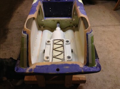

I split the difference between full slant/angle cut and straight up...i was undecided as well and splitting the difference looked good. I cut the rear and formed foam from the inside of the hull to build a base layer on the outside, then built up the thickness from the inside.

I'd say 2" would be the minimum. You can glass it from the outside but personally I've always got better results doing it from the inside (plus it gives you an opportunity to rid the hull of wet foam and replace w/ the right stuff and drain plugs). One item you'll have to account for is the exhaust tube has a large muffler at the end. If you're cutting at an angle this will need to be addressed. I cut the muffler piece off all together and welded up an angled outlet to match the angle of the hull after it was shortened. You can see the angle I cut mine at in the second pic.

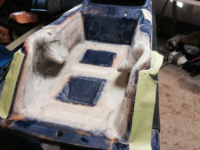

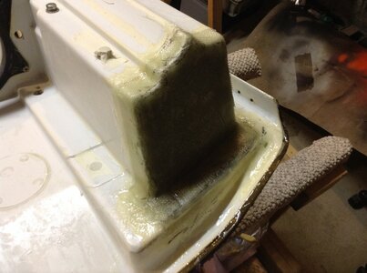

here is what cutting the tray looks like, but you may know this from searching other builds.

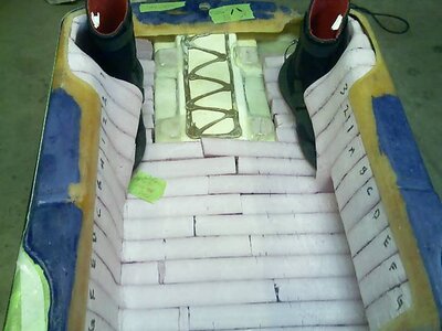

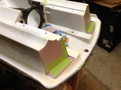

thats the best foot hold design i have seen yet! looks comfortable. so pink foam seems to be the most prefered for that vs just using all poured 2 part foam
schicks
Karma Enforcer
West Michigan
takes more time to do pink foam vs pour foam, but it is the only way to go. It is impossible to seal it up 100%... water will get in. Use pink foam and put some drains in.
