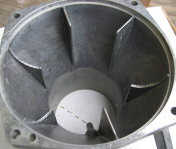

:raincloud: Discovered this just after the Daytona ride. (I'm in the process of some more experimentation with different stuff). Did anyone ever see broken stream straightener fins before? The stator vanes in the pump are perfect (144mm mag w/1" setback). :raincloud:
Probably just high frequency resonation from cavitation = metal fatigue. :burnout:
