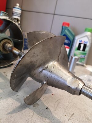

I have this 144mm impeller from a 93 Superjet.
Will this fitt to all superjet?
Can someone tell from this markings what pitch it is?

Looks pretty rough might consider having it restored by impros
Agreed. Leading edges are rough, and there is quite a burr on the outer edge = betting the OD is worn and out of spec. "IF" it is a 144mm, I believe by the numbers it is a 14/17. All 144mm impellers will interchange physical size wise.

It's a bit ruff, especially that blade that's worst.
If it's 144? You mean that it's worn down and missing some millimeters?
