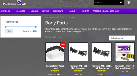

I was planning to eventually install these Pro Watercraft hull extensions on my 550sx because they will not take in and hold water like the stock end caps reportedly do:
But now that @fastgtfairlane says that it will turn faster without end caps, I think I will try riding the ski without the stock caps first.

Yeah I've looked into the pro watercraft ones as well. With their open design on top and around the steering nozzle it would seem those would give you full range of steering without impeding the flow from the nozzle like the stock ones do.
