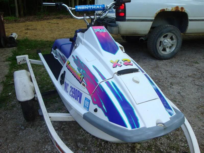

Just picked up a 93 X2
b.lee
Team Cheeseburger
1993 X2
Came from the original owner
All stock.
Just added the bars when I got it home.
I've been reading this x2 section, but still would like all suggestions on mods / fixes.
School me on the X2 if you will. (already read the wiki)
The more I know the better.
I've always wanted one and got a good deal on this one which is all original, from the original owner..purchased new in 1993. Freshwater only.

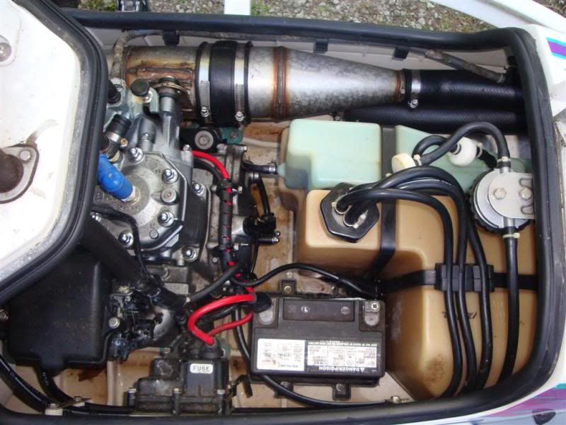

What is this? and why should I be afraid to pull it?
crankcase drain, a slide gate that lets water out of the motor
good idea, but as it ages, once opened they stay open
and allow in air to lean out your motor
get a block off plate and do away with it!!

Anyone know how the battery is held down on a x2?
Mine has no straps or anywhere to hook straps.
edit: looks like it uses some kind of screw down strap?
which i didn't get from the original owner.... it didn't come with a battery and they most likely forgot the straps.
Wilke
X2 stole my life
Indialantic, FL
there should be rubber straps that hook onto the battery tray. The areas where the tray notches out for the srews there are hooks molded into the under side of the tray.
ksmith83
( o Y o )
the battery tray should have small hooks on the outside of the tray. The owner probably forgot to give them to you, they are rubber style straps that go over the battery, similar but smaller than the ones holding your gas tank.
b.lee
Team Cheeseburger
Small hooks are right, I looked there twice and felt around...
I figured it was just like any jet ski.
Seen what you guys posted, went back and found them.
Used the straps of the old ladies XP, nice and tight.

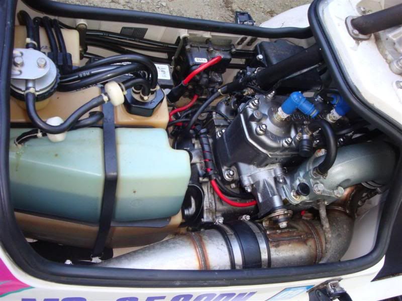

Anyways, were does a stock X2 piss out the hot water at?
Vumad
Super Hero, with a cape!
St. Pete, FL
Well it ran good, floated, stayed dry.
Top end seemed lacking, compared to the 550.
But out of the hole it seems pretty good.
There's a pisser on the front left of the boat. Follow the line that comes off the head pipe next to that pull plunger you had asked about.
Also, if it's the same stock pipe as my 650sx (which I am pretty sure it is), there is a second nipple that goes into the bottom of the pipe. I can't remember.... but I think that nipple went to a through hall fitting out the back... and some is emptied into the chamber for the waterbox. I'm not 100% on any of that.

The pisser on the front left ain't pissing =(
I rode it around 3 different times, after each time I checked the pipe and cylinders, which were only warm to the touch.
I guess I'll have to see if that line is clogged.
Anyone have anything else I can check?
A lot of water came out of the exhaust after loading it back on the trailer and starting it up for a few seconds.
But none out of the pisser when I was riding it... (Some water was coming out of the pisser under the seat)
b.lee
Team Cheeseburger
Pisser and hose were clogged.
Thats not really a pisser, its the water draining from the little cubby compartments under the seat. where the fire extinguisher sits.
