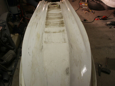

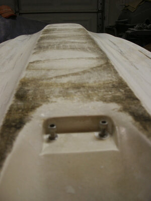

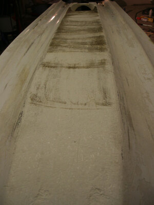

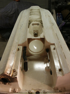

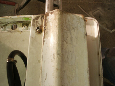

ok, check out my mangled hull. Just get some 410? Or should I get some bonding tape or 4 mil fiberglass? :dunno: I think the clowns before me that owned the ski pulled it behind a truck on a paved road :sneaky: :bigeyes: :wink:

Yeah I would go with a combo of about 50% #410 and 50% #406 it makes it harder to sand but also much tougher,any of the west system or other fillers can be intermixed that way #407 might be a good filler for that also.You can fill any deep gouges with the #406 and do the final finishing with the #410,its good to keep the #410 as thin as possible,you pretty much use it the same as bondo.
