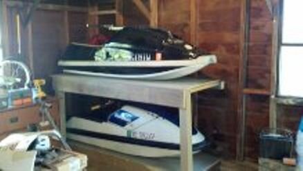

Alright I did a mild build on my SN a few years back, holds,pole,turf,paint ext.. I decided its time to go all out, well not endless funds all out but what i can afford. I stated chopping her up about a week ago i will post some pics here soon. My rocker nose from CarterB just got here today, adjustable bob footholds are on the way, along with glass materials. Just recently picked up a 61x and electroinics for it! Origanlly a 650. Any comments/ suggestions are appreciated!! Will be doing a -4 and some reinforcement as well.untitled.jpg Heres a pic of the ski before i start its the top..

what kind of tank will you run after the carter nose is installed? stock with internal fuel fill? or a/m whats the exact goals with the skis?
I plan on just running the stock with the interal fill, as far as the goal i ride flatwater with the occasional V-waking , so just to make it more functional for that. In no professional just like to have fun doin rolls and trying the occasional flip lol
Alright a little update, the rear is finished, i just got done glassing the Rocker nose have to do the inside yet.. after the nose is wrapped up ill be installing bob adjustables every thing is cut and ready to go just waiting on some epoxy to get here. Moving along... heres couple picsDSC00758.jpgDSC00756.jpgDSC00757.jpg
Alright.. heres a few more photos! The holds are glued in and been pouring some foam and shaping but i ran out.. so have to put in an order. So far i think its goin well spent 3 hours cleaning the shop up tonight couldnt work in that mess. Well im waiting on some stuff to get here im goin to glass the inside of the rocker and wrap up the engine compartment. I think ive decided to run a 9ltr kart tank seeing as its cheaper than an internal fill and i believe will look cleaner (any suggestions) also ill be looking for a b pipe here soon so if your selling one let me know. Till next time!!
