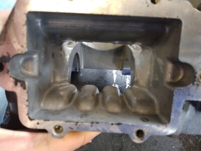

Has anyone heard of Yoda racing? I bought a 96 blaster and it has a motor with their name engraved into it. I cant remember where the old owner said the motor was purchased, maybe Aqua Jet in Mississauga or Brampton Ontario 10+ yrs ago.
Just looks like a basic motor. Pulled the head off and it looks like it has been cleaned up or some porting.

Yoda racing. Clearly somebody that thought they were the guru master. Never heard of em, but that dont mean much. Porting is all about specs. Once you know the right numbers and can run a porting tool, it'll create power. Pete debaghian has been a local guru forever. Jetski James used his numbers and wala.
Can't tell anything about the transfers by the pic but the main port has been hit fairly good. When the top of the port is a big rounded arc it's more linear power. When it's flat across the top it's violent. Piston on the way down reads the opening. Big arch and piston reads a small opening that gradually gets bigger. Bla bla bla . Ive seen group k and jetworks with mostly rounded tops lol

Protec moflo flame arrestor adaptors and for sure it's reverse jetted. 120 pilots and probably 110 mains or there abouts. With 120 pilots the popoff is very low. 135s in this ported sj that just ripps. Engraved edge motorsports. Also unknown to me but it's some crazy porting. Your transfers are raised and angled back to the rear of the cyl. That's correct

There is always a step from the gasket surface to the machined dome. The step is gone so it's been cut a bunch which it needs to be. Stock good compression is about 160. Raising the exhaust ports with porting lowers compression too
