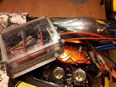

think i made a new record:arms: 2 busted MSD total loss box in one summer=) both went by driving a shunny day on a lake.. driving normal and just bum no spark or just tiny spark... after first box i did all my wiring new.. and went to lake.. few hours later my box was dead again:squint: so now 1000$ after i build a water proof box to protect my box coils and solenoid
i hope it works:notworthy: all new wiring again..
but now im not sure whit few wires how they go... so my start/stop kill switch has 4 wires red,white,brown and black where these go.. i think black for ground yes but msd pink and violet and red brwn and white from start are mystery to me.. and i dont want to bust my new box for doing it wrong.. and second guestion coils must be grounded to engine case BUT is it ok if i ground them to engine case and battery?
i hope it works:notworthy: all new wiring again.. but now im not sure whit few wires how they go... so my start/stop kill switch has 4 wires red,white,brown and black where these go.. i think black for ground yes but msd pink and violet and red brwn and white from start are mystery to me.. and i dont want to bust my new box for doing it wrong.. and second guestion coils must be grounded to engine case BUT is it ok if i ground them to engine case and battery?
