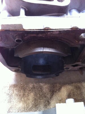

OK, so I was inspecting my cylinder a little closer this weekend and noticed a pretty big issue... The rear cylinder sleeve is cracked at the bottom. I am assuming this happened when the piston came apart. Now I have to decide whether to try and find another cylinder on EBAY, do the cylinder exchange from SBT, re-sleeve the cylinder, etc. Any suggestions?
