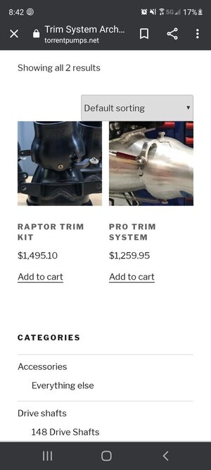

I just realized that what I thought was the Torrent trim is really the Xscream trim.
