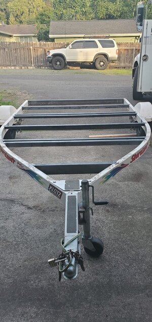

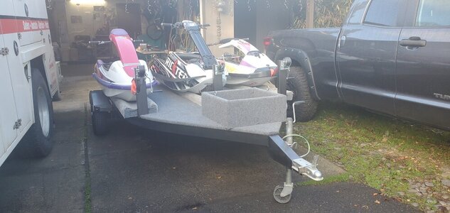

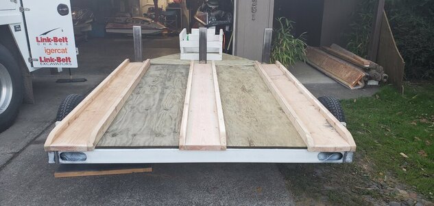

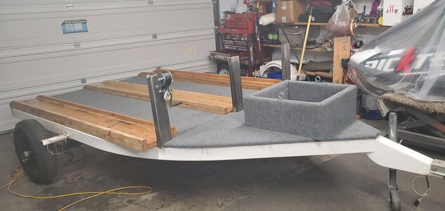

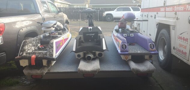

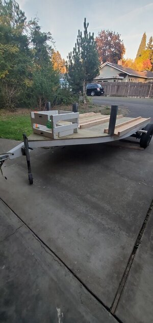

Started with a 2 place shorleander, welded in crossmembers. Built bunks out of 2x10s n 2x4s, sheeted in-between and carpted, skis sit high enough to clear fenders.

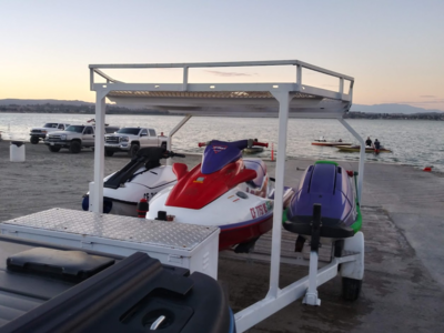

I have a converted boat trailer that holds five skis, four going across the trailer and one going up the nose and I have another with two skis side by side and one going across in front of them.
