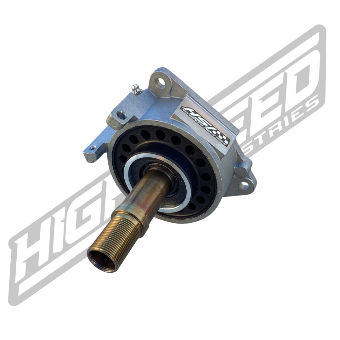

Midshaft new 500 (i have an oem mishaft for a wave raider. i suppose i could cut this in half by just purchasing another midshaft for a superjet. thoughts?)

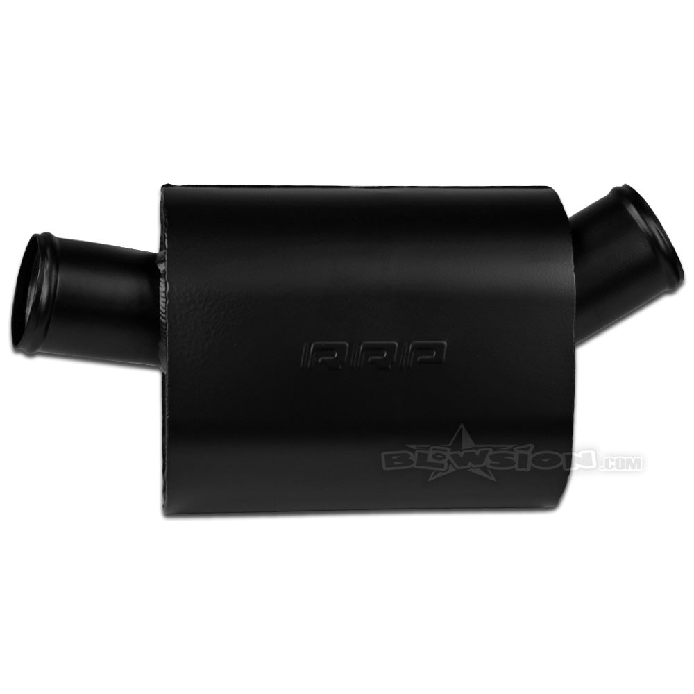

- b pipes are more like 1200 now, I think. Riva racing is easy to buy those from. Easier than factory pipe direct. Call riva and get in the wait list cuz they are not often in stock

- if your wave raider midshaft housing and couplers are in good condition, send it to JM for rebuild to save vs buying another.

One thing I didn’t see on your list is a midshaft spacer. Aftermarket hulls (tigercraft at least) need the spacer for the mid shaft to seal properly against the bulkhead. I forgot this on my SV1 build…
