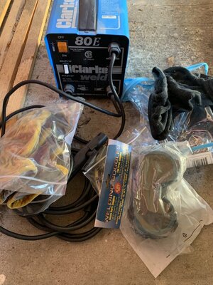

I want to be able to build anything. I need to learn to weld. I want a TIG and to weld aluminum. That’s holding me up, because it’s is expensive and difficult. However, I have this little welder my uncle gave me. I haven’t had any interest in welding steal so I have ignored it, but it’s a great place to start. So let’s get started.
This is what I have. What do I need?
Clarke 80e welder and manual, new I think, should work…
Retired structural firefighting gloves, out of date, but should be safe.
Retired nomex hood, out of date, probably no welding use
Goggles as seen, I am willing to buy a welding helmet if these aren’t safe
I thought I had rods, but I don’t see them with the welder, so I’ll post what I find, or buy what I’m told to
I don’t have scrap steel, but Alro metal is up the road and I can get remnants, or I can find some scrap.

I dont know what welding those goggles were intended for, maybe plastic welding? You will need a helmet. I myself dont use the autodark ones but they are very popular.
I do zero stick, but for gtaw all you need is a helmet. gloves ,brown jersey gloves work fine for small dc jobs. You will need something like a gauntlet and leather for aluminum and higher amp dc. A light jacket or buttonup shirt to cover your arms and neck. Sunburn is what you are protecting against
I think for stick you will need a hat under your helmet and a jacket that both withstand spatter.
do you have an angle grinder yet? you will need one of those to prep your joints.

Those are torch goggles, like a shade 5, meant for welding with a flame not an arc, shade 9-10 is what you’ll want for mig/stick, tig anywhere from 9-12 depending on what you’re doing. Don’t rule out a $50 auto dark helmet, but if you go auto dark make sure it has 4 sensors not just 2. Real welders use fixed shade helmets, the field of view is bigger. Burning some rods with that buzz box will be good practice, there’s a lot you can learn before needing to actually light up on some aluminum. When it comes time to get a tig, you will need an inverter, from talking to you in Daytona sounds like a transformer is out of the question with ur shop/power situation. I have heard good stuff about the alpha tig machines but have not personally ran one yet
Wow actually looked at the picture again, those googles say shade 10 right on them, definitely would still recommend getting an actual mask though

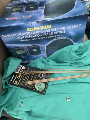

Time to find some steel.
(They just gave me a few rods to try for free.)

The set the helmet I got to the highest setting. I wanted auto darkening because it would reduce the things o have to think about while learning. I set it at the highest setting, 13…

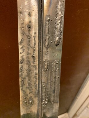

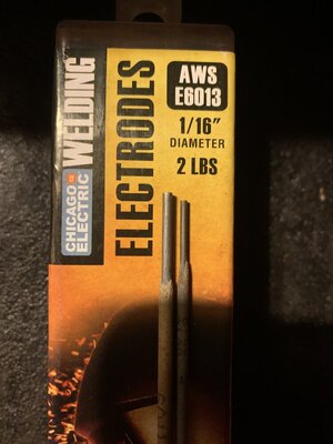

I think the rod they gave me for free with the helmet is 1/8” and too big for the welder. Every time I touched the left side it immediately stuck to the part. With a lot of struggle, I got it to arc a few times but only for a moment.
I ran up to harbor freight and got some 1/16 rod. Seemed to work real well on the right side.

Some of the sticks can be hard to strike an ARC. You may need to drag them fast across the material at the start, so they don't stick. Setting the AMPs higher can help. Your machine might not have the power to run thicker rods...
You've got the idea, just keep laying beads until they look pretty and you can see penetration on the backside. Then try different techniques of puddling.
