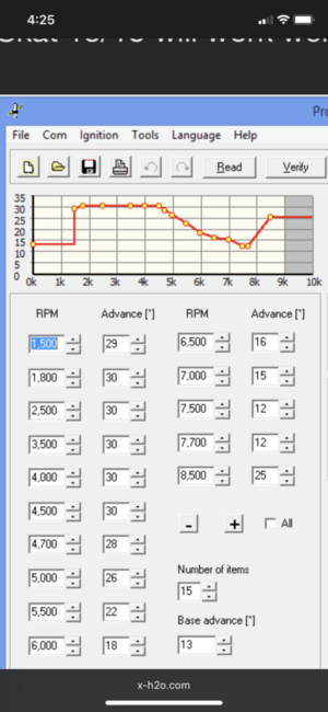

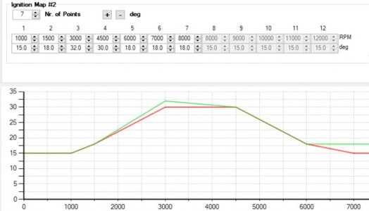

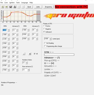

Could you help me with your opinion regarding the correct jetting and ignition curve for Sxr 800 limited with factory dry pipe, TBM head with 29cc domes , dual Novis 48 maxflow, mag pump, proigni ignition..... (it is marked stock on the ignition, so I don't really know which curve is uploaded, presume stock )?
Current setup is 145 pivots , 132,5 mains, LSA 3/4, HSA 2,5.
Right now it almost feel like a turbo lag, no bottom to mid, but then there is an instant hit, but still the top rpm could be better. I would like to gain some bottom end and a more linear power band.
I have a hard time to explain but when riding on a very close course, I always have to hold some throttle because of the crazy brake effect of this ski. So when coming out of corners the acceleration is poor, but at the end of the straight line if you just accidentally blip the throttle the ski just skyrockets you out of the turn.
I have also tried to change the main jets to 137,5 but it seems that I have just obtain a hesitation at high rpm to wot.
My current curve is attached.Screenshot_20220702-094454_Messenger.jpgScreenshot_20220606-114955_Gallery.jpgThank you

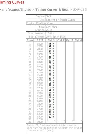

If you where running an MSD multi channel pro TL ignition system the ignition curve would look different.. at least on Yamaha it does..
Advance starts at 1000 RPM
Full advance @1500 RPM
Carry full advance until your desired start retard RPM.. say 5k
Then pull desired amount of timing out thru rev limit
JC look at his timing curve

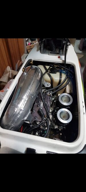

The ski has a dynafy 14-21 impeller and it is not on the edge.....It was a race ski and it has a whole package ...TBM grilled head, drop down domes, Tassinari reads, NOvi 48 carbs, dry pipe, dual cooling with 4 pissers, Mag pump with trim, Pro igni ignition, .......The ski as a package has everything for ripping, just the domes are to be safe for our best pump gas, because we don't really need for going that far =)

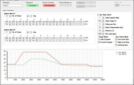

Its a very mild curve you are running. I would emulate the wax v3 on that ski and you will be fine on pump fuel. It the timing up top that does the damage, when your dynamic compression is getting high

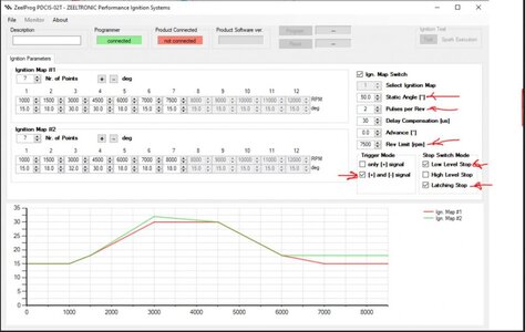

Thank you for all the answers, but it is still a little unclear for me which curve should I try, because of course every is totally different and I really don't understand how this thing works, so I am not comfortable to make my own one out of all these options.... I have too many questions =) Some curves bump the advance straight up to 30 at 1500rpm and then hold it to 4500 (like the curve posted by JC-Superjet)....some are more linear like the Advent curve posted. What is the better choice for my setup? @waxhead could you be please more specific with your curve opinion. Thank you again !!!!

Do JC’s curve on your next water test… it’s a more normal looking curve and will help eliminate the curve a source of issues….

a slowly rising curve will give you the same sort of power, it will slowly rise.
Here is the wax V3 curve

Use JC’s curve, reduce total timing to 28 like Kevbo suggested and water test the ski…
I had to use a known good curve once to isolate a drivability issue… with a known good curve installed I was able to see how the rest of the boats parts were working..

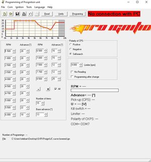

Ok , so like posted below? Or should I also lower the timing at 1500 and at 8500 rpm? What about the rev limiter setting and Base advance? Is it OK ?
It doesn’t look like you can adjust the curve at the 1,000 rpm point…. Can only chose baseline advance…? If it were adjustable @1,000 rpm, I’d start the advance at 1.000 (12 deg) and be at 28 at 1,500…. But that doesn’t look possible
So that curve looks good… adjust and have the curve finishing @ 12 deg thru rev limit and beyond, set rev limit to 8k… no rise after rev limit…
The 7,500 rpm point and beyond 12 deg…
Slovenia
Yes, it is possible to add another colum. Will also set the advance at the rev limiter to 12. Thank you! The jetting is now 145p, 137,5m ....thinking to lower the mains to 135.
Stockton
Oh ok…. Add another column at 1k…. 12 deg at 1k and 28 at 1500…

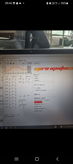

Hi. Been runing this ignition curve now with 145p and 135m. I have found out that the reason for the strange trottle response was that the trottle cable was not hooked in the right spot on the trottle lever not alowing to open the butterflyes all the way and also stretching the trottle when the pole was all the way down :)
Anyway, now I am running 95 ron octane fuel with the above jetting and curve and the acceleration is way more linear, but at wot the aceleration and speed has decreased drasticaly. Now it reaches max speed of 48 mph. Heavent really measured the max rpm achieved, but you can notice that the peak rpms are way lower. What do you guys think? Is this beacause of the new curve or is this now a carb tunninh issue?
