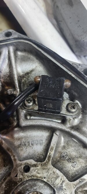

2008 sxr 800 with a tbm racing total loss flywheel. Is it possible to buy a stator pickup ( crankshaft sensor, Pulsar Coil) seperate from having to purchase the complete stator assembly from Kawasaki

You cannot buy just a stator pick up.
You can buy a junk stator and just use the pick up
I have done that before as I have a pick up get loose and rub on flywheel.
