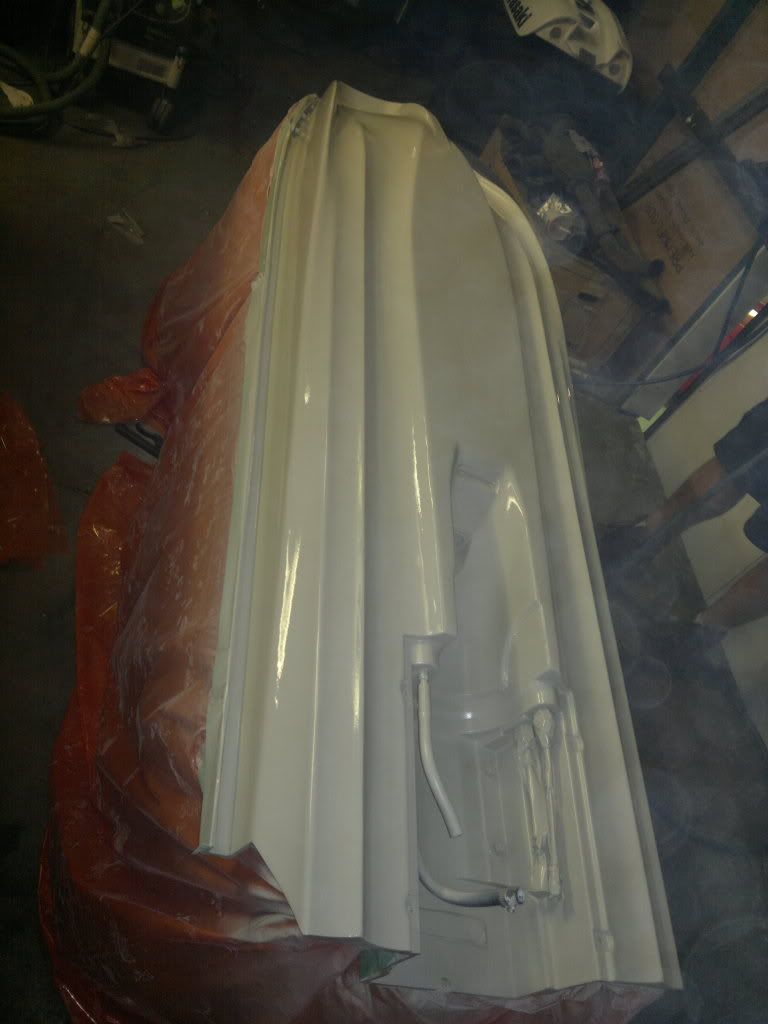

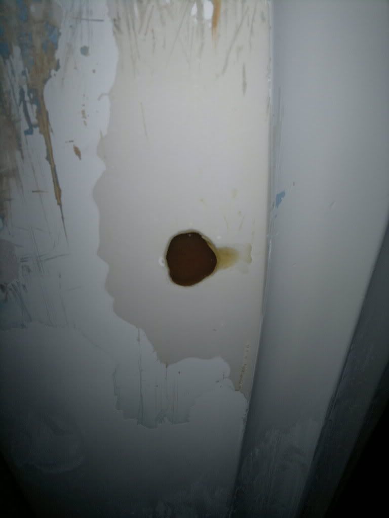

A couple of the fiberglass repairs

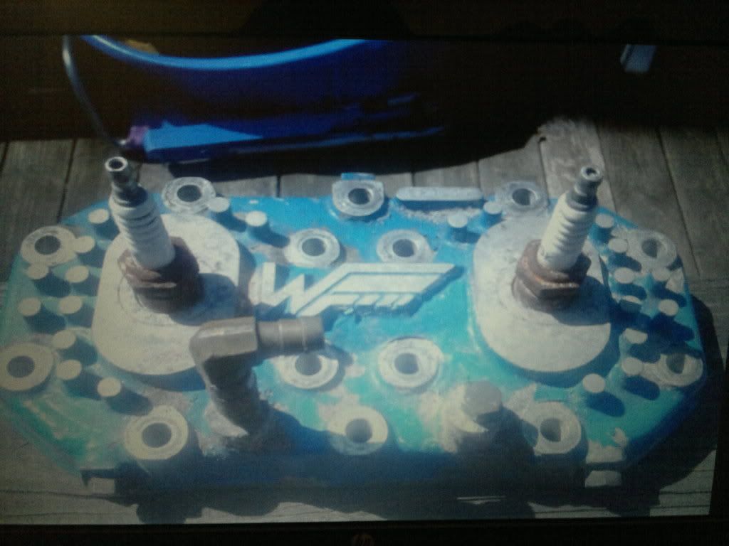

And a real big thanks to Nuklear6 who has offered me this West Coast head to bump compression and help the 650 along a bit.
Cheers mate!

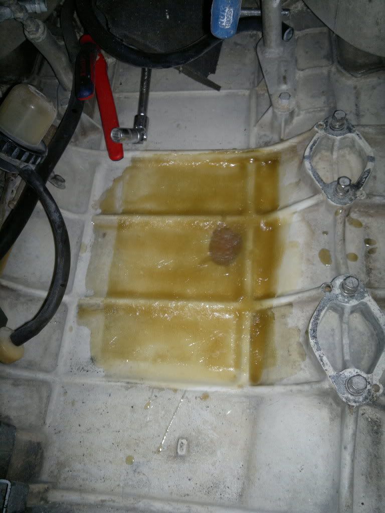

It says Styrene resin. It's a kit from a local boat shed. To be honest im not too happy with it after i put it on outside the hull but its not gonna leak. Il sink a few cans of etch primer into it after sanded and give the hull some serious paint hopefully hiding it....

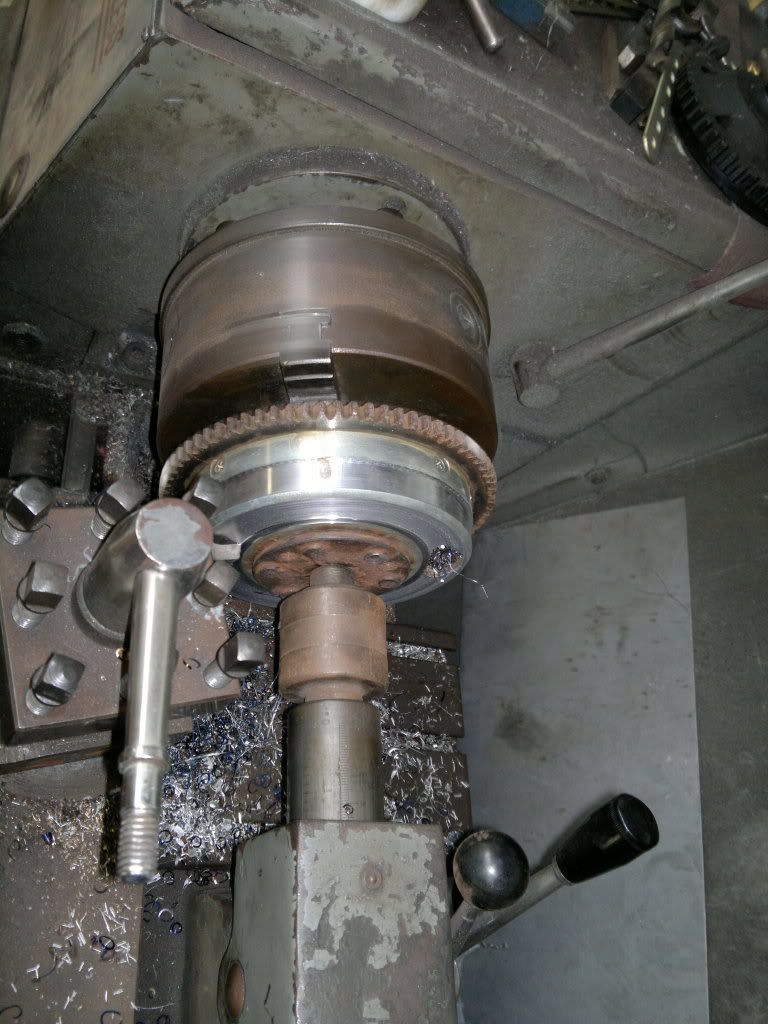

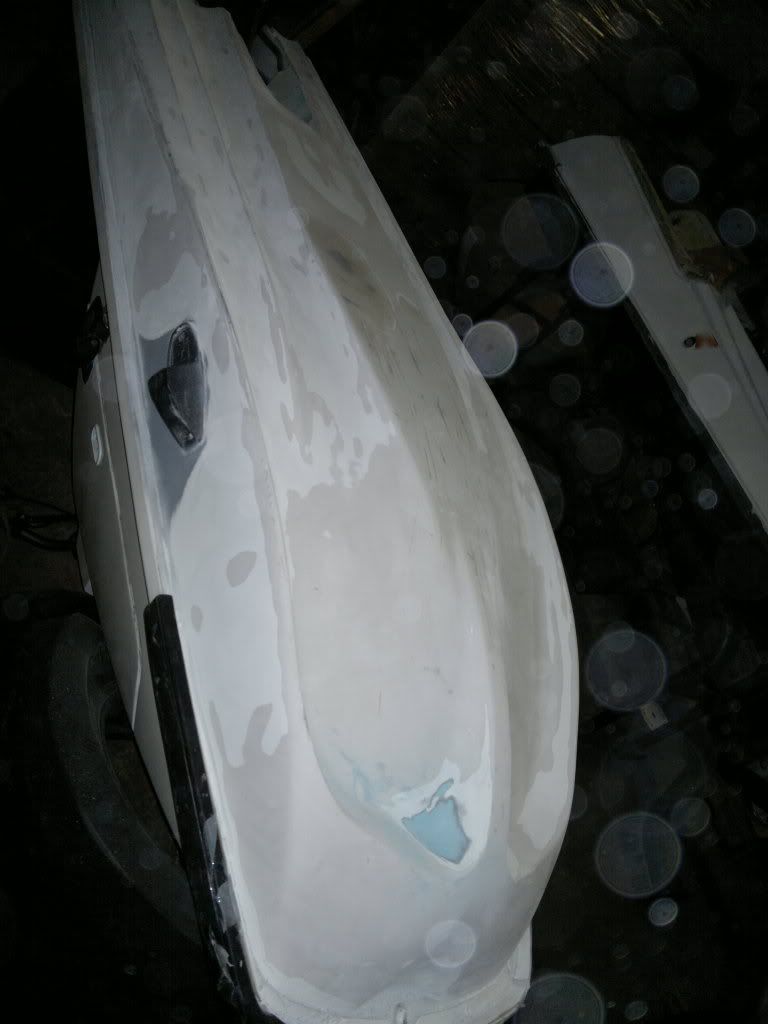

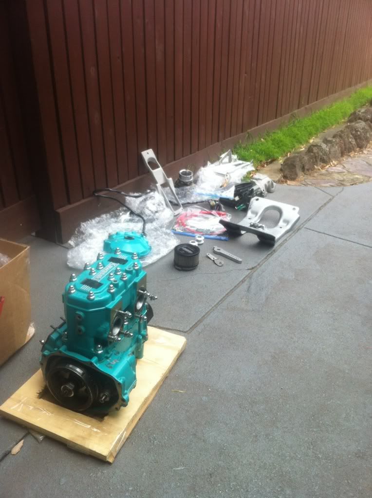

A bit more progress today having almost completely sanded the hull back to the glass bogged up the bad scratches and blew in a 2 pak primer. Received the 9/17 scat prop and pjs toploader from a member on another forum and now are looking at cutting out the old pump liner in favor of a newbe due to swelling. Motor will be screwed together next week. I had a crack at taking some weight out of the fly wheel and it is now 145 grams lighter. Thats going to be balanced next week also.
We have decided to spray the hull black and the top deck at a later stage in candy apple red with a trick paint effect with some nice big ass green Kawasaki stickers under the clear coat.
Im a lil worried my 1.5 inch chop job might have been excessive with cutting down the sides a bit much? Thoughts?

Line one from the head can be A) plugged as in the pic of the head, or B) can have a fitting that goes to a pisser.
