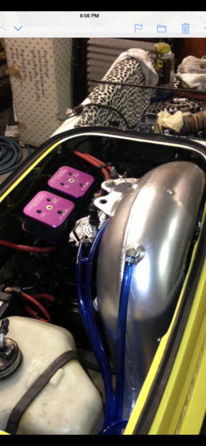

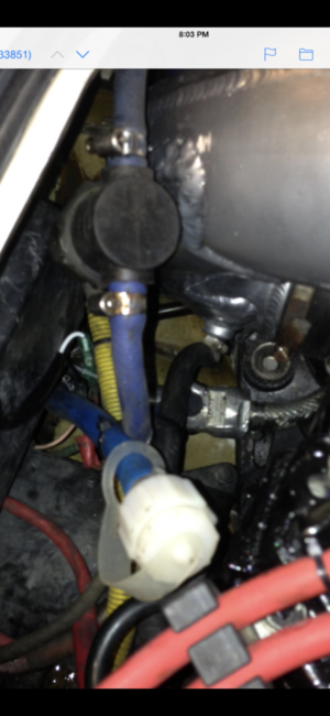

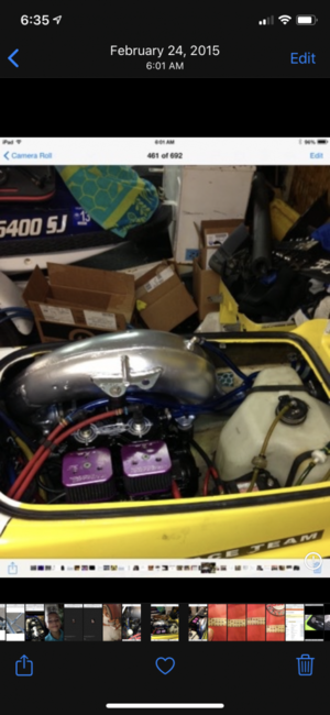

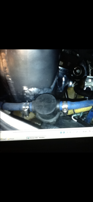

so I set up as parallel cooling or whatever it’s called . So pipe had it’s own incoming line from pump and engine on its own line from pump.. 2 separate cooling circuits
So one line from pump to fitting on exh manifold, then both fittings off head to pissers over board... engine cooling
One line from pump to lower fitting on pipe, put T in this line and run A hose to a water strainer, then run off the strainer to injection fitting on manifold.. if your gonna run EWIC put it in this line... next hose off top of pipe to the other fitting near stinger, then The other stinger fitting over board to a pisser..
Not the best pics but all I have anymore

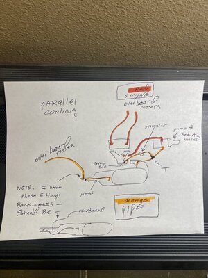

I know this is an old post, but I am going to be running dual cooling on my 701 with an ADA head and Type 4 pipe with water injection. Do you happen to have a diagram of how the water lines should be routed? Thanks in advance!
I have never run a type 4, but if I was running a type 4 wet I'd run the water lines the same as I have done on a laydown wet pipe. 2 lines from the pump, one goes straight to the manifold, the other t's before the manifold. One side of the t goes into the manifold, the other goes through a strainer then t's again, on to the spray bar and one to the stinger. Adjust restrictors on the stinger and spray bar as needed. I like to use high speed jets, probably need about a 110 in both places but it will depend on a bunch of things so test and tune.
Two lines out of the head and directly overboard.
I like these strainers:
I like the spray bars that are commonly used on laydown pipes, jetmaniac sells them (he probably sells a good stainer too).
I use the Jetmaniac Strainer, think the 40 micron screen, hope this helps
