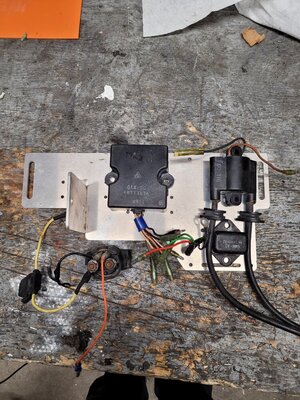

Hi,
I know all MSD and ATP total loss electronics all run without an ebox..
Is there a reason why I shouldn't do the same on stock electronics?
All parts seems to be sealed..and btw the stock cdi won't be used. I will be using the latest zeel y62t box.
I could also put deustch connectors everywhere instead of the oem bullet style, will be more water and less pita.
This is for my freestyle ski.
I've run a Zeel on a plate and used an oem Sea Doo starter relay. Mine was kind of a "temporary solution that I never got around to changing" situation for a Kawasaki setup, but so far no issues, only about a season in use on a freshwater only ski. I'm planning on doing similiar but nicer setup on my freestyle ski.
Someone knows what is the name of the connector used for the seadoo starter relay?
