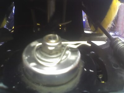

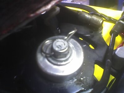

I'm sure this has been covered a million times, but here's my version..
Ace Hardware - 5/64 SS Cotter pin, 5/64 drill bit..
  1. Drill bolt through nut and post while nut for steering is installed at desired tightness..
  2. Make sure this is the spot you want it...
  3. Use a cutting wax or some oil so you don't burn up the bit right away.
  4. slide pin in the hole to ensure clean fit
  5. bend the pin so it locks into place good and won't slide out
the total cost for this fix is $1.45, I already had the drill bit :Banane01:
