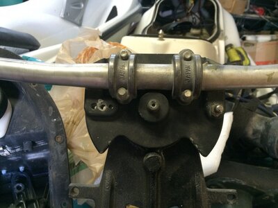

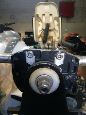

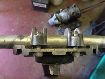

modified stock turn plate about 5 to 6 inches shorter with straight bars

yea, hack it off and put straight bars. its hillbilly but about the only option unless you put the entire $200-300 sealed bearing unit on there. i could mcgiver something else but not sure who else could or couldnt.
