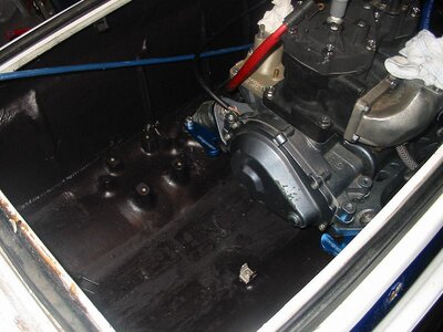

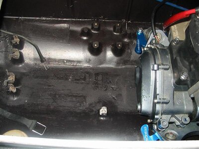

I decided to use some Rustoleum black barbeque paint. It holds up to gas because I spilled some when I was putting the tank back in, and I just left it there to see what it would do. I just wiped it up about an hour later, and it didn't leave a mark.

I used brush on paint. You can get the rubberized stuff the same way. If you're talking about making repairs to the hull I you'd have to sand it down. I filled the bond line and put a few layers of glass on the sides before I painted it.
