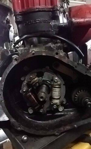

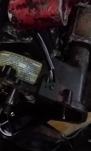

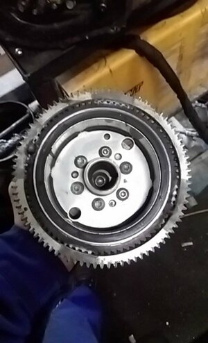

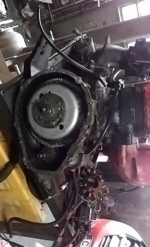

Hi! We have modded a yamaha flywheel to work with polaris crank and with yamaha stator adapted on polaris cases inside flywheel - and then connected to a yamaha 2 cyl e-box - and is working very good - yamaha flywheel is smaller and lighter - and can be machined to approx 1.2kg - and together with an MSD enhancer can be great pn those engines. Who wants to make the modd i can do the flywheel for 200 - this is the hardest part - but i need a polaris and yam flywheel first. And i'm from Romania - so very far from USA where are mou8st polaris owners. Anyway - is done - is running - and can arrange any static advance i want in the process

Here are some pictures with this modd

Hi! I did it to a polaris virage 700 - think is the same crankcase. But you need to combine the crown and middle part of polaris flywheel with the yamaha magnets side flywheel as in picture and also make the stator of yamaha 62t fit under the flywheel - need some machine work but then you can have the MSD inside
