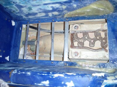

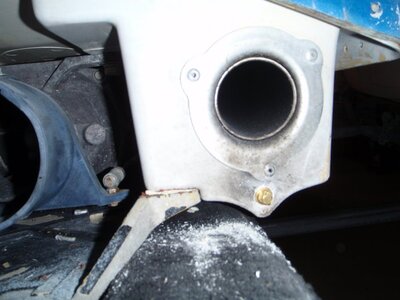

Need to find a way to make my RN more seaworthy. Years ago I removed all the foam from under the tray and installed a simple boat scupper at the transom with a pvc pipe leading to the lowest point in the bilge. This cheap scupper has worked really well for riding on lakes - always a dry bilge when running. The tray is reinforced and is really solid. The area under the tray is now just an empty "sealed" area with no foam and two copper drain plugs at the transom. The problem is the area under the tray leaks. At the end of the day it is always full of water. Like drains for 3 or 4 minutes from both plugs. I have tried to find the source of the leak with no success. I don't have the time to cut up the tray again. I would like to find the simplest solution possible. I use the ski for pulling surf boards, tubes, and a lot of first time riders take it for a spin- so I need to make the ski seaworthy before my luck runs out. Below is what I am proposing to fix it and some pics of the ski. Please let me know if you have any other ideas.
1. Get a new hood seal
2. Install my hood strap and also use the factory latch
3. Replace my two copper drain plugs with Blowsion Vacate valves or the small versiplugs. Is one better than the other???
4. Replace my boat scupper with a Versiplug-max

A ski with no foam and letting newbs on it kinda sound disatrous enough. Maybe just do larger drain plugs and add a bilge or two to get the water out quicker.
Sounds like you know what you need to do with the ski (reseal and add foam under the tray) just looking for a bandaid.
Good luck sir. Looks like a nice ski!

id just put versi plugs in the tray. it will drain as you ride. Been contemplating it myself but cant bring myself to drill a hole.

I think no matter what else I do I need to do the big and small versi-plugs. Has anyone tried the Blowsion vacate valve?
