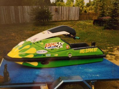

Welcome , to be young again...1st ski i bought with some graduation money in '93 a '89 650sx. Two seasons later, I painted it,broke handlepole trying nose stabs. stayed with factory white. then typical add ons , hydroturf/handle bars/finger throttle/grips/intake/44sbn/fa/ tail cone for the pipe. We had a local shop,Hyper-tech that tried to support a couple local racers and was the place to get the goods. Made many trips to lake michigan on that trailer.
