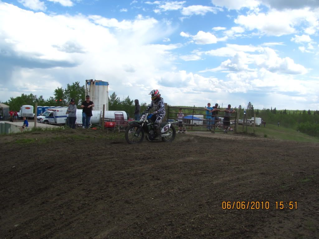

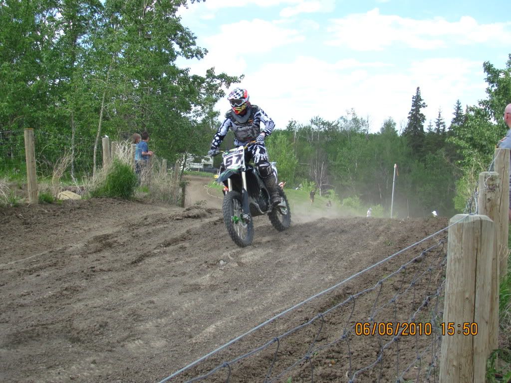

Update! Slowly my moto conditioning is returning. The pump is fading and the feeling is coming back.. Even did a local race and got 8/23 in novice.. Not bad for 5hrs on the bike at the time.
Got just over 10hrs of track, sand and fun on the bike
