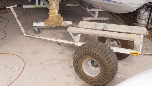

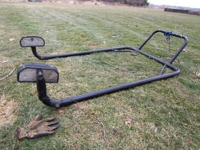

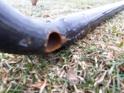

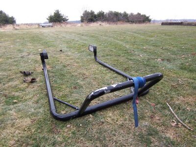

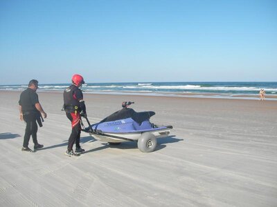

Here is a B-1 dolly I made from off the shelf muffler tubing welded together , the same can be done for a SJ , just make it narrower , I can picup and move my B-1 all by myself anywhere , in daytona I need no help from the trailer to the water .. ask CATTLEDOG how he likes it , hes walking next to me in the pic , just FWIW
OMG that was the ultimate cheese!!!! I didn't make it 20 seconds... ha ha
:scared::scared::scared::scared::scared::scared::scared::scared:

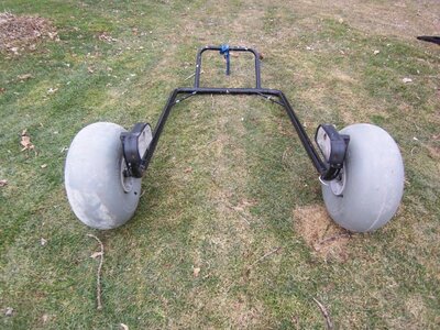

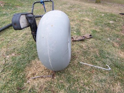

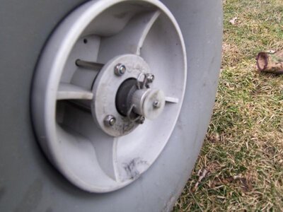

You wouldn't happen to have some more pics closer up and of just the cart, would you? That looks exactly what I need to get to welding up.

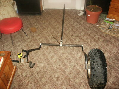

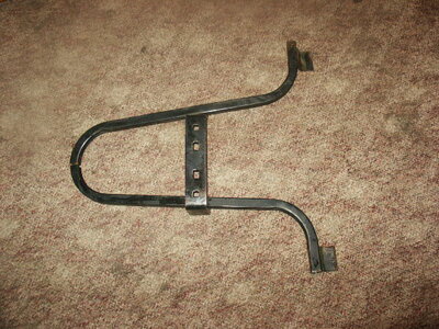

Here's mine that I made from a old mid 80's Honda 3 wheeler rear end/axle/wheels. It has a adjustable handle for different length ski's and to balance the load(square tubing inside square tubing).
Going on 10 years now with no problems... works great and was dirt cheap to make.
