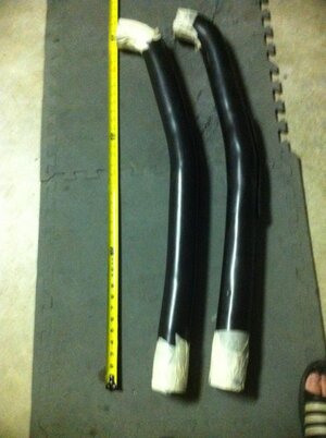

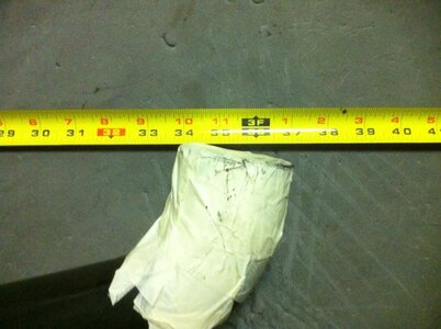

What's the diameter and length of the long exhaust tube for a RN? I know the SN is a bit smaller, but don't know the official # for either.
Damn ok thanks got to find a new tube now lol

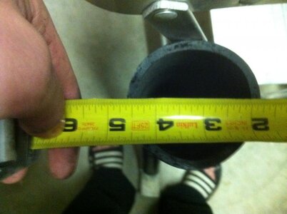

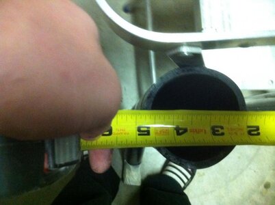

EDIT: The correct adapter is a 2" to 2-3/8" The RN exhaust tube inside diameter is 2-3/8" and the inside diameter of the SN exhaust tube is 2".

Just to be clear, are we talking 2 3/8" ID or OD for the RN exhaust tube? Im about to order a tube for my FX-1 project...
I tried to measure the RN tube I installed into my square, but I cant get a good measure on it. Too close to tell haha
