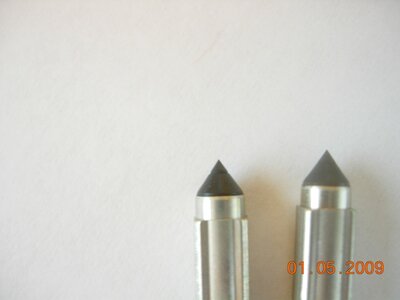

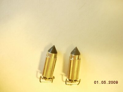

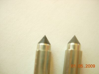

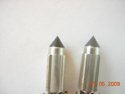

Is this needle bad enough to jack up my bottom end?
Is this needle bad enough to jack up my bottom end??? I am guessing so!

That left one looks like a dribbler to me for sure, but the popoff pressure is pretty high (which should eliminate low idle dribbling)
I'd replace it to be sure.
It is defiantly getting replaced but could it make my off idle run terrible? It is very inconsistent. Sometimes it feels like it is loading up, them some times it will stall. It will idle all day long no issues and clears up after ¼ throttle.
added note: Has a bad shake/vibration at about 1/8 throttle.

Yes, Those are pretty bad...Replace only with OEM Mikuni Original Parts. Do not use aftermarket junk.
From the symptoms you describe, this should get the jetting consistent, then jet changes will respond like they should.
I swaped them out with OEM Mikuni Original Parts last night. Will give it a try this weekend.
Thanks to all for the help. Hope to see some of you in Daytona!!:Banane57:
